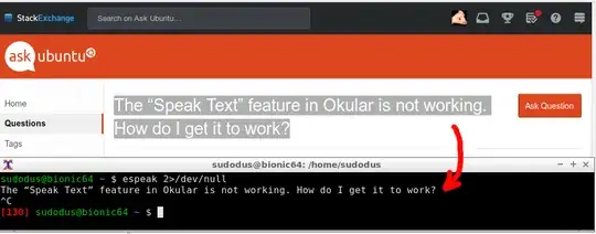

See the screenshot:
Pipe text into espeak
You can redirect the output into espeak and listen to all the text from a pdf file,
pdftotext your-file.pdf /dev/stdout | espeak
or if you have a text file, read from it directly,
< your-file.txt espeak
or if you want a talking clock
LC_TIME=C date '+%A, %B, %-d, %Y; %H and %M' | espeak
