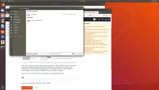

However, when I install the system the only partition I see in nautilus is this one:
Here

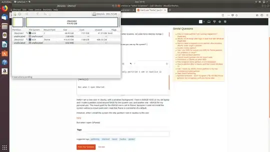

But when I open GParted:
Here
Am I doing something wrong? Is the 410 GB one not used, though it is listed in GParted, and how can I use it?

With your settings, I wouldn't expect that you find your "Home" in "Other locations". Your home is mounted when your system boots. You can access it straight via the "Home" (and Document, Music, Pictures...) link in Nautilus, the file explorer. It is not an "Other location", it's part or your File System, even if installed on two different partitions.

But all of this managing mount points is invisible to you, as the user of the computer. In normal day-to-day usage you don't typically care which directories are on which partitions; when you make a file, all you think about is the path /home/curly/maharajah.txt and you let the kernel worry about which partition to actually put that file on. So, unlike in Windows, partitions are meant to be invisible during normal use, and you work with the illusion that there is only one big filesystem that contains everything on the system. Some file managers, like Nautilus apparently, help promote that illusion by not even showing you what partitions are mounted.
What this means for your specific situation is that you (probably) already have things set up the way you want. Your 50 GB partition is mounted on /, and your 410 GB partition is mounted on /home, and that means anything you create under /home will be placed on the 410 GB partition while everything else on the system will be placed on the 50 GB partition. (Well actually there are other "imaginary partitions" created by various Linux system components, but forget about that for now.) It's just that Nautilus is not making it very clear that both partitions are being used, and in fact being kind of misleading by showing the space usage for only partition 1 in the "other locations" screen.

GParted generally shows the actual mount point of the partition. If a partition is like some external storage device or which has nothing to do with the Ubuntu like in my case I have 3 partitions which doesn't include any system file of Ubuntu, it is mounted in /media/ directory which generally creates a mount point there like I have mount point like /media/kulfy/DE14D51314D4EF8F for my one of the partition. It was created automatically. And this partitions/storage devices can be accessed from Other Locations as well.
Your GParted shows that the mount point for /dev/sda2 is /home thus the partition is already mounted and /home as the mount point. So, there is no entry in Other Locations since it performs as an important part of the main installation. You can also run findmnt /dev/sda2 for more info.

  • Computer, which is listed under "other locations" is a bookmark for /. This is your root directory.
  • Home is a bookmark for /home/$USER/ where $USER is your username. This is your user's home directory. You can manually navigate to your user's Home directory in Nautilus if you click on "Computer", then click "home" and then click your username.
However, the mount point of your partition is /home and this directory is where you can access your partition in Nautilus.
To manually navigate to your partition in Nautilus, click on "Computer", which is your root or / directory, and then click "home". This is top level directory where the disk or partition is mounted, /home.
