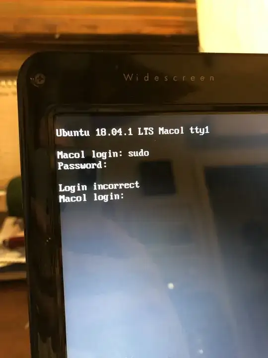

UPDATE FROM 18/12/2018
Guys, thank you but no luck. I managed to get to a terminal with Crtl + Alt + Fwhatever but I have the following screen:
Macol is the username used during installation, I tried with the password but I keep on getting Login incorrect. I do not even know what I should type after Macol login, the username is already there. The password is the right one (4 numbers), the keyboard has the right layout, I tried to type it in the previous field (the PC has no numpad, I used the row under F keys) and no problems. I also tried CAPS on/off for the username. sudo of course is not working.
My options now are:
  1. Login with your help and try your previous suggestions
  2. Format everything by installing Xubuntu 18.10 and call it a day

You should be able to drop to a command shell with Ctrl+Alt+F3.
From there you can log in and run some fixit commands:
sudo apt update
sudo apt upgrade --fix-missing
Then you can try to install/reinstall xubuntu-core/desktop
sudo apt install --reinstall xubuntu-core xubuntu-desktop

Thank you for your help guys, but I ended up re-installing everything, Xubuntu 18.10 this time.
