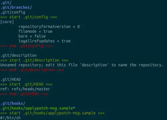

I'm not aware of an easy way to do that, but I wrote a script that does something similar. Instead of a fancy tree listing like tree does, I made it flat, like find.
Output (in an empty git repo like your example):
.git/
.git/branches/
.git/config
==> start .git/config <==
[core]
        repositoryformatversion = 0
        filemode = true
        bare = false
        logallrefupdates = true
==> end .git/config <==
.git/description
==> start .git/description <==
Unnamed repository; edit this file 'description' to name the repository.
==> end .git/description <==
.git/HEAD
==> start .git/HEAD <==
ref: refs/heads/master
==> end .git/HEAD <==
.git/hooks/
(The ==> ... <== header/footer is inspired by tail)
Here's the script:
#!/bin/bash
# Globs include hidden files, are null if no matches, recursive with **
shopt -s dotglob nullglob globstar
for file in **; do
    # Print filename with an indicator suffix for filetype
    ls --directory --classify -- "$file"
    filetype="$(file --brief --mime-type -- "$file")"
    # Only print text files
    if [[ $filetype == text/* ]]; then
        printf '==> %s %s <==\n' start "$file"
        cat --show-nonprinting -- "$file"
        printf '==> %s %s <==\n' end "$file"
        echo
    fi
done
It's not pretty, but it works. Color makes it pretty at least:
#!/bin/bash
for file in **; do
    ls --directory --classify --color=yes -- "$file"
        printf '\e[32m==> %s %s <==\e[m\n' start "$file"
        printf '\e[31m==> %s %s <==\e[m\n' end "$file"
        echo
    fi
done
Screenshot:
Screenshot showing filename colorized by <code>ls</code>, "start" marker in green, and "end" marker in red

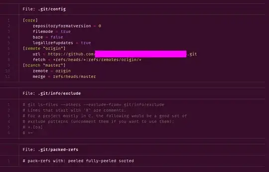

First install bat, the "cat clone with wings".1
sudo apt install bat
Now the solution is a one-liner using the the find command. find is preinstalled as part of GNU findutils.
find -type f -exec batcat {} +
The find -type f part lists all the files (and not the intermediate directories) in the current working directory. The -exec batcat {} + part passes the list of files to bat so that all may be printed with headers.
It acts as though the command were batcat .git/branches .git/config .git/description .git/HEAD .git/hooks/applypatch-msg.sample ....
The output looks like this:
       │ File: .git/config
   1   │ [core]
   2   │     repositoryformatversion = 0
   3   │     filemode = true
   4   │     bare = false
   5   │     logallrefupdates = true
   6   │ [remote "origin"]
   7   │     url = https://github.com/blah/blah.git
   8   │     fetch = +refs/heads/*:refs/remotes/origin/*
   9   │ [branch "master"]
  10   │     remote = origin
  11   │     merge = refs/heads/master
       │ File: .git/info/exclude
   1   │ # git ls-files --others --exclude-from=.git/info/exclude
   2   │ # Lines that start with '#' are comments.
   3   │ # For a project mostly in C, the following would be a good set of
   4   │ # exclude patterns (uncomment them if you want to use them):
   5   │ # *.[oa]
   6   │ # *~
       │ File: .git/packed-refs
   1   │ # pack-refs with: peeled fully-peeled sorted
In the teminal bat also colorizes the output and highlights syntax.
Screenshot of colored terminal output
bat shows a binary file like this to avoid printing junk to the screen.
       │ File: .git/objects/06/aaaaaaaaaaaaaaaaaaaaaaaaaaaaaaaaaaaaaa   <BINARY>
The binary detection isn't perfect so sometimes screen junk still appears.
       │ File: .git/objects/84/bbbbbbbbbbbbbbbbbbbbbbbbbbbbbbbbbbbbbb
   1   │ x^A+)Q130040a50UMJ(I-.�-(�,K,I�-I�-�^A2�*^Sss^X��:r^V�o��yAP&�}ّ��͇^A�/
You can make bat's output more or less fancy by adding options --style and --color. For details check the man page or the README on GitHub.
