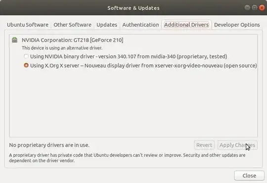

  • Run on Terminal software-properties-gtk
  • Go to "Additional Driver" tab.
  • Select NVIDIA Driver and click on apply changes.
NVIDIA
  • When completed reboot.
