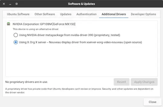

I just blacklisted nouveau, but I see that it is still being used. Would someone please help me understand this?
My new installation of 18.10 would freeze when logging in. To resolve this, I blacklisted nouveau in grub by updating /etc/default/grub with
GRUB_CMDLINE_LINUX_DEFAULT="quiet splash modprobe.blacklist=nouveau"
(The solution was from NMI watchdog: BUG: soft lockup - CPU#2 stuck for 23s!, which was the issue had I experienced.)
I am glad that I am now able to successfully login, but I see that Nouveau is still being used, and this is confusing.
I thought I just blacklisted it, so why do I see it as active in Software and Updates?
What does the line modprobe.blacklist=nouveau exactly do? (Perhaps I misunderstand it).
Are there any disadvantages of adding modprobe.blacklist=nouveau to grub?

Possibly, there is a conflict between the open-source driver with that of the graphic card from Nvidia. I will write down the solution that worked for me, on a Lenovo ThinkPad P53 when installing Ubuntu 20.04 LTS, I faced some issues.
Follow the steps written below:
  1. Boot to Ubuntu, but before you login in to Ubuntu, press Cntrl+Alt+F2
  2. run the following command:
         sudo nano /etc/modprobe.d/blacklist-nouveau.conf
  3. add the 2 following lines, save & exit
         blacklist nouveau
         options nouveau modeset=0
  4. run the following command
         sudo update-initramfs -u
