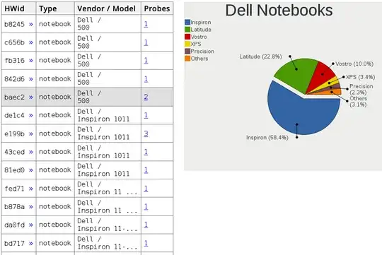

As it was written in another answer by linuxbuild:
A database of Linux-compatible computers & devices: https://linux-hardware.org/
Timeline of tested computers: https://linux-hardware.org/?view=timeline
A tool to analyze and count your computer: https://github.com/linuxhw/hw-probe
