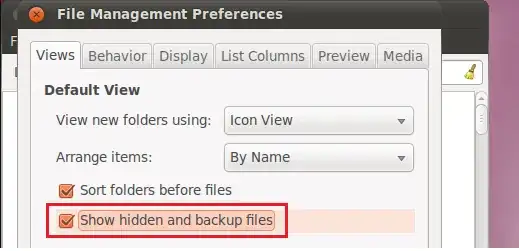

You may have checked showing hidden files in preferences. In Nautilus (file browser) click Edit>Preferences and in Views tab if Show hidden files and backup files is ticked, remove the tick.
Hidden Files Setting
To fix this in 13.04, I had to right click on the dialog and uncheck "Show Hidden Files"
In Ubuntu 14.10 you have to click on the gear button on the right of the toolbar and the click on Preferences -> View and remove the tick on Show hidden and backup files.
