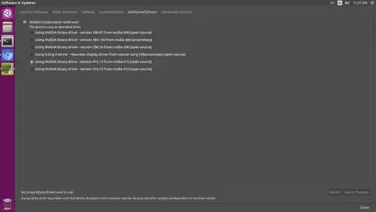

I am trying to install graphic card drivers for my GTX 1060
first I ran sudo ubuntu-drivers devices for recommended driver
which is 415 version
But as you can see in screenshot that apply button is disabled for only 415 option
how can I install that?

Before everything, run nvidia-smi to see which driver version do you have. If you have a version lower than the recommended one, then try this method (it worked for me with Nvidia GeForce 940MX):
  1. Run this command ubuntu-drivers devices to see which Nvidia driver is recommended for your graphic card
  2. Run sudo ubuntu-drivers autoinstall.
If the previous command didn't install the desired version of Nvidia drivers, try this: sudo apt install nvidia-<driver_version>.
You can find more information and different methods in this link
