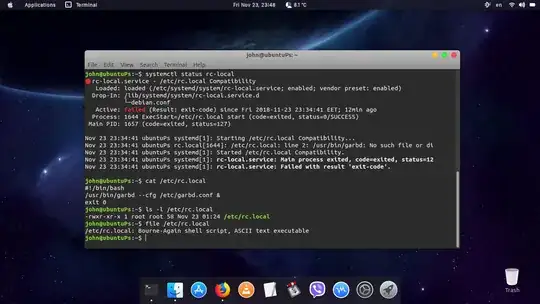

i tried to install /etc/rc.local and i am stuck in this step
terminal pic

The error you're getting is:
Failed to execute command: Exec format error
That means systemd is trying to execute /etc/rc.local as an executable (for instance, a shell script), but that is failing since it appears the /etc/rc.local file is not a valid executable.
Please take a look at its contents. If it's a script, do you have a proper "shebang" line, such as #!/bin/sh or #!/bin/bash at the beginning?
Does the file have the "executable" bit set? (You can set it with chmod +x /etc/rc.local).
Please edit your answer and include the output of commands ls -l /etc/rc.local and file /etc/rc.local, which will help identify the exact issue you're having.
UPDATE: From your comment below, looks like you were missing the shebang line #!/bin/bash in your /etc/rc.local, adding that line fixed the problem.

systemctl status rc-local
FAILED

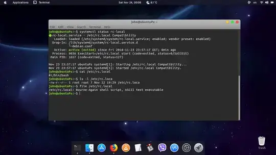

screenshot from terminal

#!/bin/bash
then I get this
[screenshot from *terminal*
