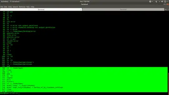

The command I executed is shown in the screenshot of my history below. It was
rm -r /home/dawn

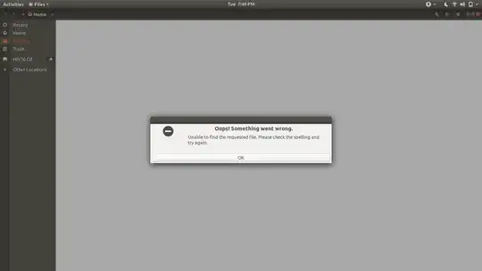

Now all my files are gone, as well as the default folders such as Pictures, Desktop, Screenshots, etc & my desktop screen has turned dark black.
When I tried to open the files icon, it's giving me an error.
Can anyone help me on this?
command history
unable to find the requested file
