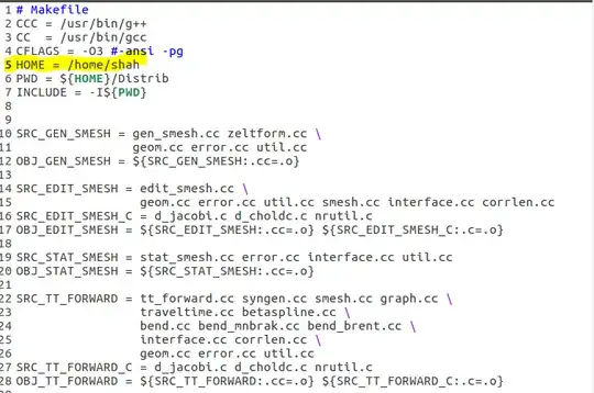

Basically I am trying to install a piece of tomographic software that I downloaded from this webpage
I changed line number 5 in the Makefile to
Home = /home/shah
Makefile changes
