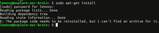

here i want to install plank (ppa:docky-core/stable), but when i tried
sudo apt-get install plank
it's didn't working also i tried install another application still didn't working and there's show me this message. Also i was tried this command sudo rm /var/lib/apt/lists/* -vf but still didn't working too
here is the message: Image
and here is output of sources.list :

Okay, I understood. You have malfunctioned Visual Studio Code (Terminal name is code) that is making other packages not installable. So do these steps:
sudo dpkg --remove --force-all code
If that fails:
sudo rm -i /var/lib/dpkg/info/code.*
sudo dpkg --remove --force-remove-reinstreq code
Confirm Apt is fixed. The following command should return no errors:
sudo apt-get update
Credits goes to here.
