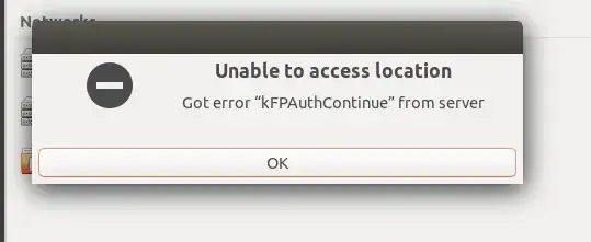

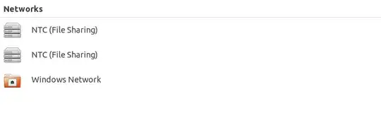

I can see my time capsule in network, but I am unable to get into it. Could someone help me to resolve the issue? The login information is correct, but getting errors shown in screenshots. enter image description here

On Ubuntu 18.04, I saw the same screen as you have. Having tried various Google searches I found a command line solution. It is not a fully automated GUI solution... but this is Linux, right.
First prepare mount point (only one time):
$ sudo mkdir /media/$USER/capsule
Then every time you want to mount the capsule:
If you as I have the same username on both your Mac and Linux systems:
sudo mount -t cifs //10.0.1.1/Data /media/$USER/capsule -o username=$USER,sec=ntlm,uid=$USER,vers=1.0
Else:
sudo mount -t cifs //10.0.1.1/Data /media/$USER/capsule -o username=MyCapsuleUsername,sec=ntlm,uid=MyCapsuleUsername,vers=1.0
You will be asked for two passwords, the first from sudo, i.e. your Linux password, the second from the capsule.
Note, I created an alias in my .bashrc file for convenience.
Note, //10.0.1.1 is the default local IP address of your capsule, assuming you did nothing special when setting it up. You can check your router setup for the correct IP. /Data is the name that you gave your time capsule, it might differ in your case.

Add this in global section /etc/samba/smb.conf:
[global]
client use spnego = no
You can mount it by command
gio mount smb://10.0.1.1/Data/
Or CTRL + L in nautilus and write full adsress

All the answers here lack unfortunately the following quite important information. The name that you gave your time capsule does not match with /Data.
The name of the time capsule corresponds to the NetBIOS aka host name. So it can be used as an alternative to the IP address. Let's say it is "TC Peter". That would be translated by the Apple Airport Utility to TC-PETER.
The value /Data corresponds to the time capsule volume name. In this case this would be now "AirPort-Laufwerk Peter" which is equal to /AirPort-Laufwerk Peter. In other languages this is of course different, so in English that would be /AirPort-Drive Peter or /AirPort-Volume Peter
However, in my example this will give the following two possible commands:
sudo mount.cifs //TC-PETER/'Airport-Laufwerk Peter' /mnt/timecapsule/ -o password='yourpassword',sec=ntlm,uid=1000,vers=1.0
sudo mount.cifs //x.x.x.x/'Airport-Laufwerk Peter' /mnt/timecapsule/ -o password='yourpassword',sec=ntlm,uid=1000,vers=1.0
Note, the apostrophes are needed if the time capsule volume name contains a space!
The uid value of 1000 is correct in my case for Kubuntu 18.04. It may be different on other Linux Distros and users. Check it with command id -u <username>.
This mounting command works fine when the Time Capsule is configured with a single password (device admin or network password). It not works when user-accounts are configured as access mode at the Time Capsule.
So that's it. I can confirm that it works PERFECTLY. It took me near days to figure this correct syntax stuff out. ;-)

On later versions of Ubuntu, Samba requires you to specify you want the old version with vers=1.0 (this previously was the default but no longer is). Without specifying this, trying to connect through Nautlius will result in the kFPAuthContinue error.
