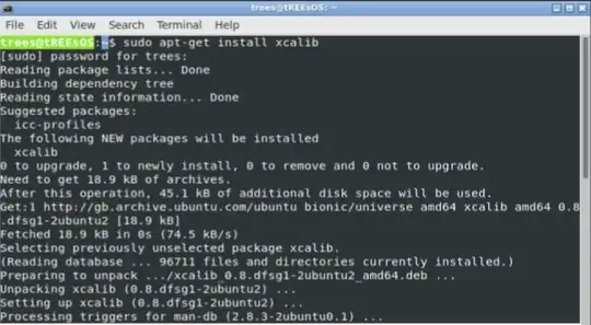

xcalib is in the repository for 18.04 and will complete this task for you.
meaning that all you need to do is type
sudo apt-get install xcalib
You will be prompted to enter your password. Then you will see the following output:
After processing triggers for man-db (2.8.3-2ubuntu0.1) ...
You should be able to simply type xcalib, which will show both how to use the package, and that the package has installed successfully.
There is a guide on Xcalib for Ubuntu here that might help you.
