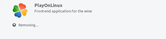

I go to Ubuntu Software, search for playonlinux and then click remove:
It does this... enter image description here

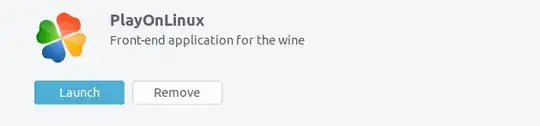

An then still shows me it is installed. Also after restart and waiting for 10 hours. enter image description here
What can I do?
