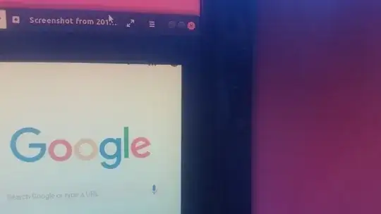

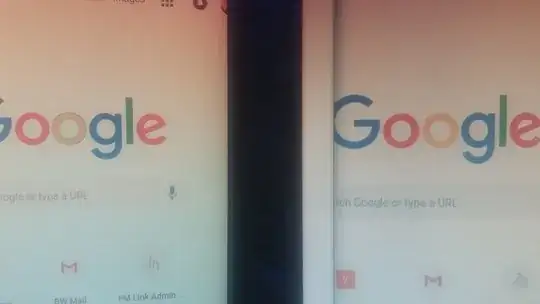

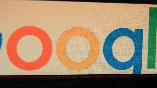

So using Google Chrome, it seems that one the HDMI to DVI monitor, yellow fonts, are rendered with a Green border, as shown below on the left.
Google Chrome Rendering
However when an image is rendered using the image viewer, the yellow is displayed correctly on the monitor, as shown below.

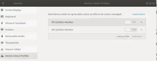

Thanks to @Alvin Liang I was able to remove the weird green border, by just turning off colour management for the display.
Settings → Devices → Colour or Device Colour Profiles
dialogue screenshot
Then restart Chrome for the updated setting to take effect.
