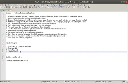

As always, fonts in menus are way too small in Wine applications, like this:
Usually, it is fixed via winecfg.
But, how to fix fonts in an embedded wine?

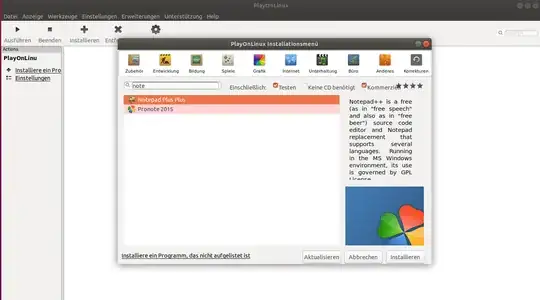

  4. Running Playonlinux: Click the Install icon. In the dialog, click the search box in Playonlinux and write Notepad select the top entry and click Install. Playonlinux install dialog

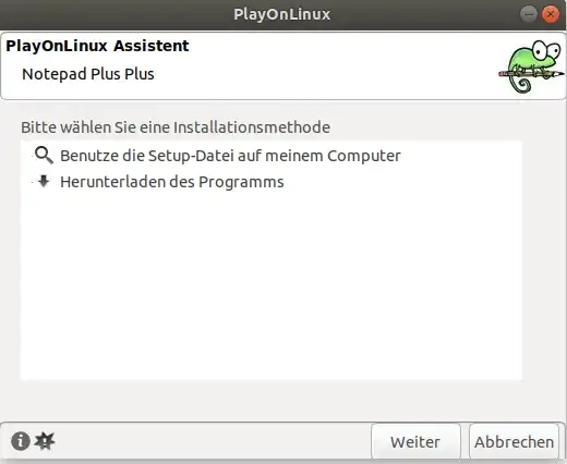

  5. There are two dialogs to click next, then a dialog which ask if you want to download or use a allready downloaded installer - this one has aa magnifying glas icon on the left. Click the maginfying glas entry. installer dialog Browse to your downloaded npp.7.6.Installer.exe file and click Ok.
This will install notepad++ with known good wine settings. First start with Notepad++
