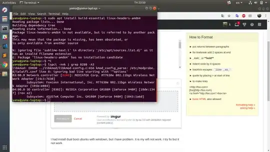

I installed dual boot Ubuntu with Windows, but I have a problem with WiFi because it doesn't work. I tried to fix it but I wasn't successful. What should I do?

Fix your first error:
linux-headers-amd64 should be linux-headers-generic
Fix your second error with:
sudo mv /etc/apt/sources.list.d/sublime-text.l /etc/apt/sources.list.d/sublime-text.list
Fix your third error with:
Edit /etc/modprobe.d/iwlwifi.conf and remove the leading " from line 8 that contains "options" (same for the end of that line, if it exists).
