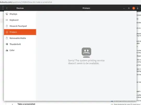

My usb printer used to work just fine, and then I tried to a setup print-server - the whole system hanged up, and after reboot, no matter what I do, I have this message from the GUI settings for printers ...
System printing service not available: system printing service not available

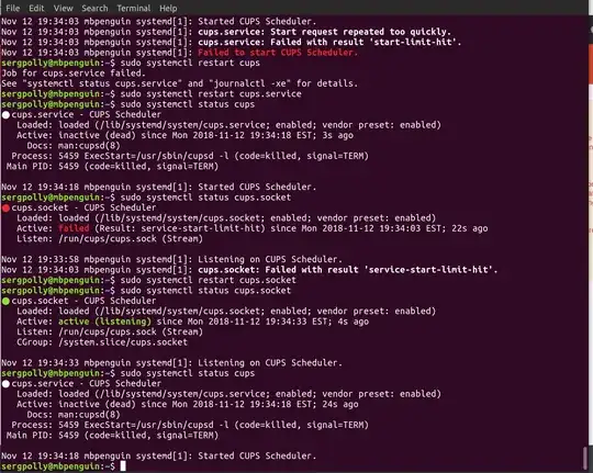

I was trying to restart cups.service and cups.socket as advised in :
Ubuntu 18.04 LTS -- Printing Service Not Available Printing service not available
and cups.socket stays "green" until I look up into the GUI settings for printers, which seems to do something that resets cups.socket again ...

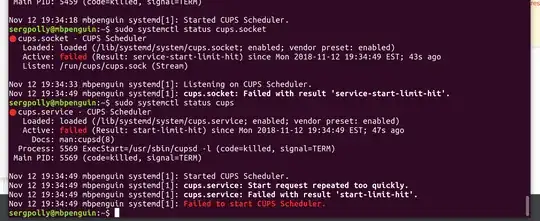

Here is a screenshot of the "best" cups situation: services are not dead
and that's how it looks like right after I check out the GUI printing settings: services fail

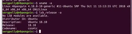

system info
