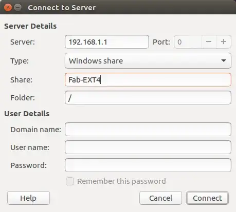

  • Go to my File Manager (Nemo)
  • File Connect to Server
Connection dialog
and that works fine!
