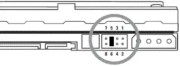

Cause: SATA II hard drives use autospeed negotiation. This enables our SATA II drives to automatically detect the motherboard data transfer rate, making it backward compatible with SATA I data transfer rates. However, some older SATA I controllers are unable to support autospeed negotiation and cannot recognize the drive. This “drive not detected” condition occurs when a chipset is incapable of correctly negotiating the data transfer speed with a SATA II hard drive.
To lock the drive at 150 MB/s data transfer rate install a jumper shunt on pins 5-6 (OPT1), shown in the picture below. (Only available on 3.5 inch (Desktop) size drives) enter image description here
From: http://wdc.custhelp.com/app/answers/detail/search/1/a_id/1337/c/130/p/227,279
