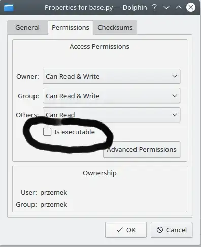

  1. Easy way in Kubuntu (Ubuntu is the same). Properties of sh file that you need to change.
solutionOne
