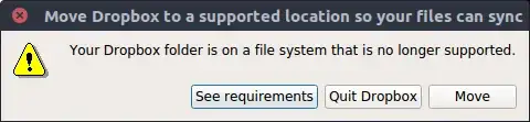

The Dropbox client 2.10.0 (https://linux.dropbox.com/packages/ubuntu/dropbox_2.10.0_amd64.deb) has just presented me with the following message:
(The "See requirements" button links here which is of no help).

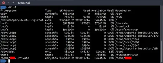

I am running Ubuntu 16.04 LTS with standard drive encryption. My filesystem is like this:
What can I do to get this working again?

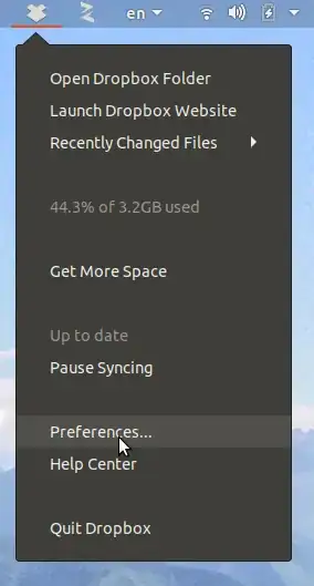

The best way to move Dropbox is through Dropbox preference
Click the Dropbox icon in the top panel, click the Settings icon, and then choose Preferences.

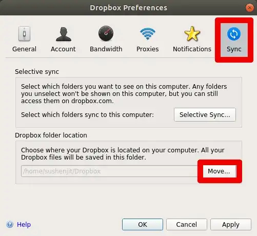

In the Dropbox Preferences window, switch to the Sync tab. Next to the Dropbox folder location, click Move.
Browse for the /home/$USER.dropbox folder and click OK. The Dropbox folder will be created inside /home/$USER.dropbox.

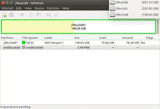

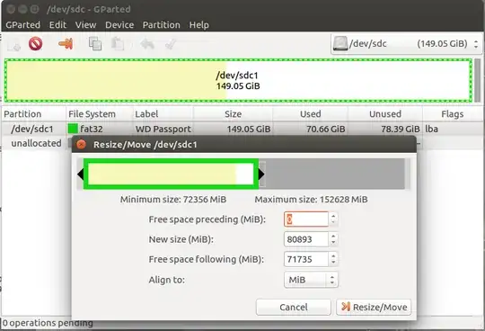

Open Gparted. I prefer Gparted because it is visual and let me "see" the drives and partitions. Click on the top right drop down and see the list of drives. Go through the list and identify the drives you want to work with, by their size and partition structure. You want to identify the / partition in your internal hard drive you want to shrink.
Step 1.3: Shrink
Make sure you have selected the internal disk.
Select the / partition you want to shrink.
Drag the right edge of the partition leftward to resize/move to make room for the new /home partition. Create as much room as you want your new /home partition to be.
Press the "Apply" button in Gparted and wait.

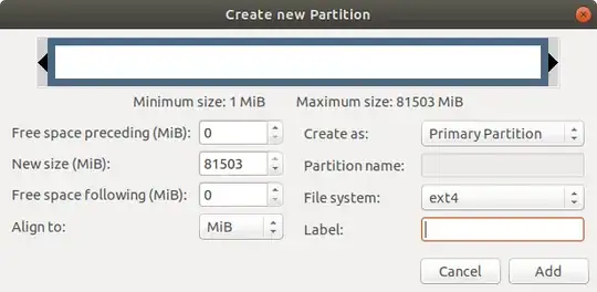

Step 1.4 Create New partition
Right click on the unallocated space you created and select new. You will see the "Create New Partition" window. Make sure the file system says "ext4" and you can keep the rest as is.
