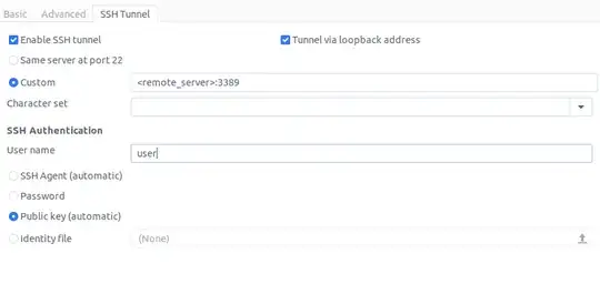

I've tried to specify the following
Tunnel setup screen
And then connect to my <aws_bastion> server and it doesn't work. I wonder how do I translate that tunnel command in GUI client?

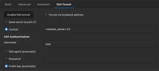

Update with the configuration that worked for me:
  • Basic tab.
    This depends on the vnc server setup in the remote.
    • Server: localhost:5900 (assuming the vnc server listen to localhost at port 5900)
    • User password: Your vnc password
  • SSH Tunnel:
    • Tick Enable SSH tunnel.
    • Choose custom: VNC_SERVER_IP_ADDRESS:22 (22 is the port for SSH)
    • In SSH Authentication: depending on the remote ssh configuration, use password or use SSH Agent.

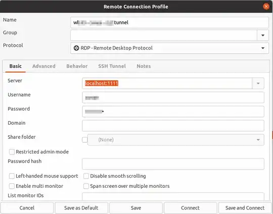

Step 2: Use Remmina to connect to the RDP host via Jumpbox: Open the Connection Profile in the Remmina Gui. In Remmina, in the "Basic" Tab, enter localhost:1111 (and the credentials of the Windows User). In the "SSH Tunnel" tab, do not enter anything.
basic tab
Note that everything is greyed out here in the tab below. Note that "Enable SSH Tunnel is inactive (already taken care of in Step (1)).

Now setup remmina with method 1, since that setup is super easy: set the Server in Basic tab to localhost:$LOCAL_PORT, and the username and password for remote desktop into the Windows VM. The BASIC tab looks like this in Remmina 1.4:
settings required on Basic tab for remmina 1.4

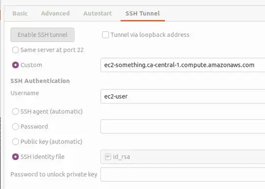

The tricky part for me was method 2:
  1. After having setup method 1, right click the Remmina RDP connection config in the remmina window, make a copy, give it a new name (I add the word tunnelled to mine)
  2. Edit the entry
  3. On the Basic tab, change Server to the value of PRIVATE_RDP_IP:RDP_PORT, eg 10.0.0.1:3389
  4. On the SSH Tunnel tab,
    • Enable the SSH tunnel
    • In Custom, put the value of SSH_SERVER_DOMAIN_NAME
    • In Username put the value of SSH_SERVER_USER
    • In SSH Identity file navigate to your private key file and select it
The SSH Tunnel looks like this:
Save and click connect. The first time, you will be asked to accept the host then RDP will start. Subsequent connections do not ask to accept.
