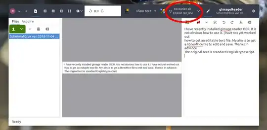

Usage
After you loaded an image, choose "Recognize all". In the example a screenshot of your post + ocr output:
(selectable/editable-) output appears on the right.
