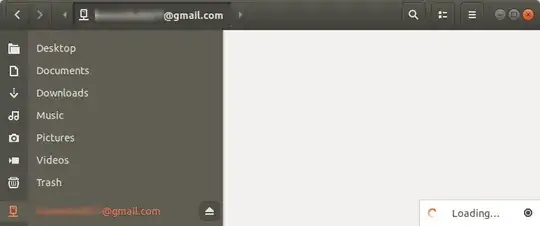

Following this answer: https://askubuntu.com/a/320333/719469, I added Google to my GNOME accounts but when I click on my Drive account id in Nautilus, it does not show any file and in the bottom right corner it keeps on loading till 5-7 minutes.
I tried adding a new file when the loading process finally stopped, it synced and uploaded perfectly.
But when I navigate to a different directory after a few minutes (not immediately) and again try opening the drive directory, it starts the super slow loading process again
I know this can be overcome be working on a different Nautilus tab or window while keeping the Drive open. But it is really inconvenient to wait so much if I close that tab/window by mistake or reboot my PC.
Loading takes place for 5-7 minutes

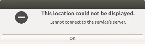

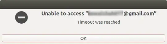

A lot of times I get these messages too:
Please note that I am using Ubuntu 18.04 and have a fast, working internet connection but am still experiencing this. I currently have around 2.5 GB data on my Drive, is it normal to experience a waiting time of 5-7 minutes for each time I open the directory or is there any workaround?
