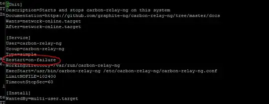

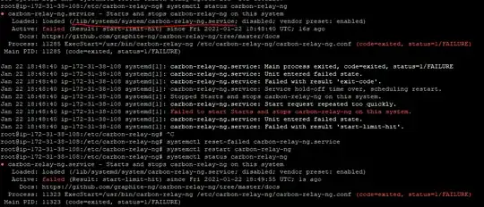

When you have start-limit-hit or Start request repeated too quickly it may be due to a Restart=on-failure directive in the service definition. Chances are, there is an initial reason for the error but it's hidden behind the one you see.
To find out: (obviously, replace carbon-relay-ng with your service)
  1. run systemctl status carbon-relay-ng
  2. find the source where the service is loaded (first image)
  3. nano /lib/systemd/system/carbon-relay-ng.service
  4. remove line Restart=on-failure and save file (second image)
  5. run systemctl restart carbon-relay-ng
  6. run systemctl status carbon-relay-ng to check real error
Find path
Open Service definition
Real error
For me it revealed the following error which I had to correct by setting the file permissions: Real error
