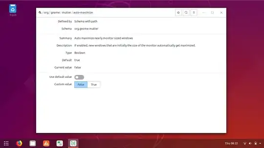

Use the below command to set auto-maximize to false
gsettings set org.gnome.mutter auto-maximize false
