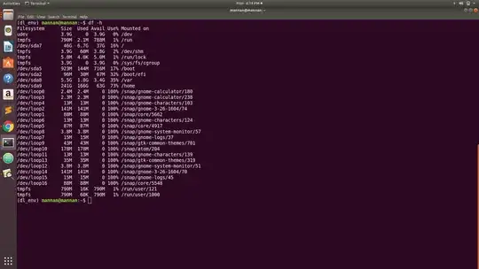

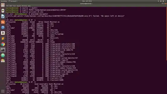

I am facing a problem about "no space left on device" as shown in the Figure below.
I am relatively a newbie and don't know much about linux. I am using Ubuntu 18.04. Checking out various blogs about my problem such as this one (which suggests that I should increase my drive size) and this one (which is quite similar to my problem) also highlights the same problem but does not specify any solution.
Can you please help any solution? Thank you so much for your attention.
PS: I have also taken screen shot of df -h as shown below enter image description here

The error message doesn't actually refer to the amount of storage space, but to the amount of inotify watches that are available for a given file system (see also here: https://github.com/guard/listen/wiki/Increasing-the-amount-of-inotify-watchers).
The quick solution (taken from the above website) would be to run
echo fs.inotify.max_user_watches=65536 | sudo tee -a /etc/sysctl.conf && sudo sysctl -p
Regards, Florian
Watch Limits are like rules that control how many folders and files you can monitor for changes using the inotify feature on a Linux system.
Example: Imagine you have a security camera system that watches your house. It uses inotify to notify you of any movement. But there's a rule that says you can only watch a maximum of 50 rooms (folders). This rule (the watch limit) stops one person from trying to watch 1,000 rooms, which would be a waste of computer resources.
So, watch limits keep things efficient and prevent anyone from using too much computer power to watch things with inotify.
We can check:
cat /proc/sys/fs/inotify/max_user_watches
To increase the watch limits, we need to edit configuration file /etc/sysctl.conf. Add this line at the end of the file:
Apply changes by running
sudo sysctl -p

This is not a problem with disc storage space. I was getting this error message while running a python script, when I had ~100 GB disc space left. There are few solutions suggested by previous users. For me, just restarting the system stopped showing this error message.
