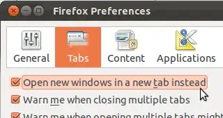

EditPreferencesTabsOpen new windows in a new tab instead is already enabled:
tabs preferences
