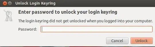

Whenever I login to skype I get this keyring message. I don't remember setting any keyring or don't even know what it is. I can login to my kubuntu with my password but to unlock keyring same password does not work. So how can I unlock this keyring or completely remove/disable this keyring option?

In kubuntu for Passwords and keys option, Install seahorse.
sudo apt-get install seahorse
After installing you will get passwords and keys option in search. Open passwords and keys, it will display available password and keys. Right click on password and select delete to remove.
After doing tons of research I couldn't find anything that would work for Kubuntu. But I got some idea and found a keyrings directory here /home/bcc/.local/share/keyrings/. I removed all the files from this directory, then did a restart and everything was back to normal. Hope this will be helpful. I am using Kubuntu 18
