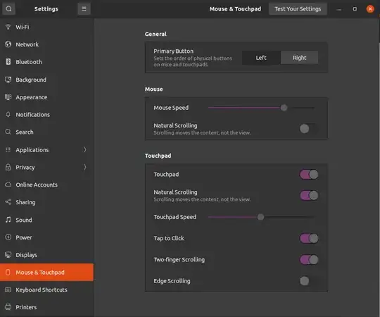

I don't know if that was already available in 18.10, but in 20.04 there is a setting for that (see Touchpad > Tap to Click):
