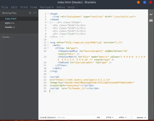

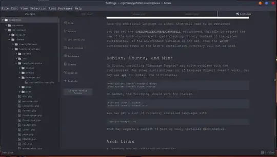

For some reason however, after opening both Brackets and Atom, I noticed that a lot of their fonts have been inexplicably changed to a monospaced font that is quite hard to read.

Here's how the programs look: enter image description here enter image description here
Atom is not in the official repositories, so I assume you're installing it from a PPA. As the unofficial Atom PPA does not provide a version for Cosmic (18.10), you're probably installing the Bionic (18.04) package, so it's most likely a compatibility issue. I compared the dependencies between the PPA package and the downloadable DEB (dpkg -I filename.deb), and the former has GTK2 UI dependencies which are being dropped in favor of GTK3.
For now it's best you use the downloadable version, until (hopefully) that or another PPA starts providing a proper Cosmic version. Don't forget to check your software sources so that they're requesting a Cosmic version from the PPA instead of Bionic.
Brackets has similar GTK2 and other aged dependencies, so it may be very hard if not impossible to get it working properly on Ubuntu 18.10 until they modernize their code.
PPA (atom_1.26.1-1~webupd8~0_amd64.deb):
Depends: git, gconf2, gconf-service, libgtk2.0-0, libudev0 | libudev1,
         libgcrypt11 | libgcrypt20, libnotify4, libxtst6, libnss3, python,
         gvfs-bin, xdg-utils, libdbus-1-3, libcap2, libxkbfile1, libx11-6,
         libasound2, libsecret-1-0, gir1.2-secret-1
DEB (atom-amd64.deb):
Depends: git, gconf2, gconf-service, libgtk-3-0 (>= 3.9.10), libudev0 | libudev1,
         libgcrypt11 | libgcrypt20, libnotify4, libxtst6, libnss3 (>= 2:3.22),
         python, gvfs-bin, xdg-utils, libcap2, libx11-xcb1, libxss1,
         libasound2 (>= 1.0.16), libxkbfile1
