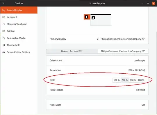

If I used my second monitor to go back into gnome-control-center, I can set the screen resolution and scaling just fine, and everything goes back to normal. I want, however, to do this from the command line.
Basically - I want to know how to set the "Scale" setting that you see in gnome-control-center (see below) from the command line. How can I do this?:
