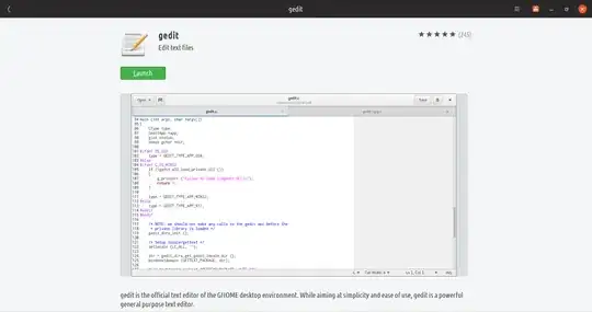

Software Center screenshot

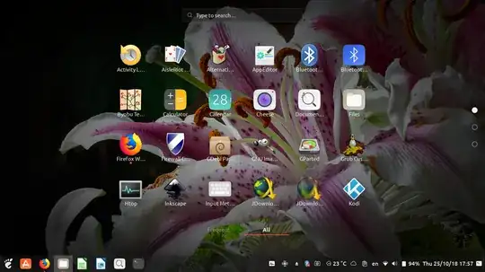

Apps grid screenshot

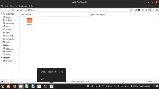

/usr/lib/gedit screenshot

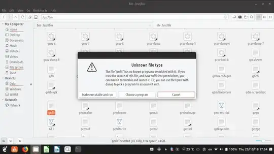

Trying to run /usr/bin/gedit screenshot

Not sure which version you upgraded from but when I upgraded from 16.04 to 18.04 I thought I had lost gedit as well. It turns out that I didn't. It's not listed as gedit in the application menu, it's listed as "Text Editor".
The answer lies within the body of the question.
In Ubuntu 18.10 gedit was replaced by a Snap package called "Text Editor" to be GNOME's "official" text editor.
AFAIK there is no other option to grab it from the UI.
