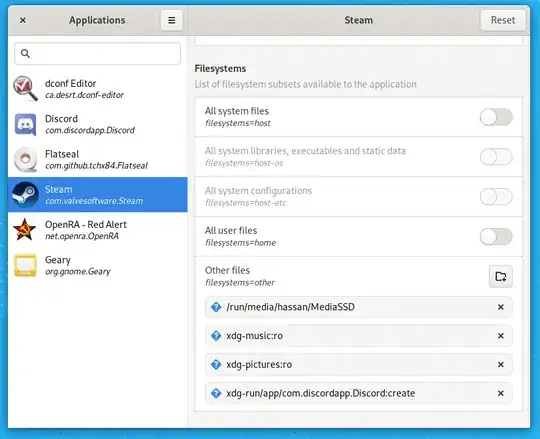

To add to the other answer, another solution that worked for me was installing Flatseal. It makes setting permissions super easy and also has the added benefit of making the existing permissions really clear. Here's what adding a directory to steam looks like in Flatseal:
Adding extra directory to steam in Flatseal
I added the directory "MediaSSD" there, everything else is default.
