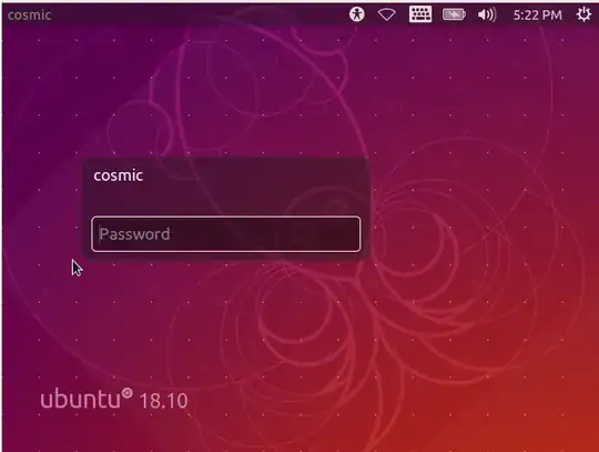

Then reconfigure LightDM as main greeter when prompted or manually with
sudo apt install lightdm
sudo dpkg-reconfigure lightdm

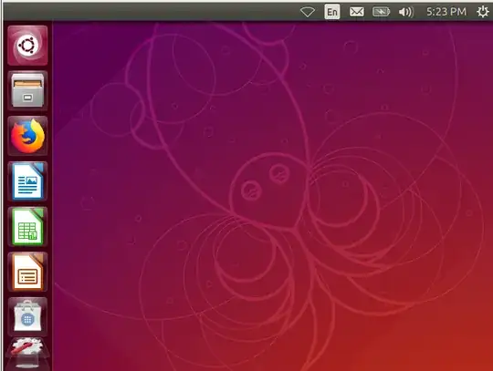

And continue to use it as before. Below are a screenshots from 18.10:
LightDM Unity
