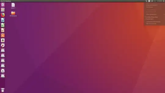

Wifi Enable but Device not ready
Output of lshw -C network:
  *-network UNCLAIMED
       description: Ethernet controller
       product: RTL8111/8168/8411 PCI Express Gigabit Ethernet Controller
       vendor: Realtek Semiconductor Co., Ltd.
       physical id: 0
       bus info: pci@0000:02:00.0
       version: 15
       width: 64 bits
       clock: 33MHz
       capabilities: pm msi pciexpress msix bus_master cap_list
       configuration: latency=0
       resources: ioport:4000(size=256) memory:b1104000-b1104fff memory:b1100000-b1103fff
  *-network DISABLED
       description: Wireless interface
       product: Realtek Semiconductor Co., Ltd.
       physical id: 0
       bus info: pci@0000:03:00.0
       logical name: wlo1
       version: 00
       serial: f8:da:0c:00:cc:2b
       width: 64 bits
       clock: 33MHz
       capabilities: pm msi pciexpress bus_master cap_list ethernet physical wireless
       configuration: broadcast=yes driver=rtl8723de driverversion=4.15.0-38-generic firmware=N/A latency=0 link=no multicast=yes wireless=IEEE 802.11
       resources: irq:131 ioport:3000(size=256) memory:b1000000-b100ffff
  *-network
       description: Ethernet interface
       physical id: 3
       logical name: enp0s20f0u3
       serial: ca:36:16:27:bf:5f
       capabilities: ethernet physical
       configuration: broadcast=yes driver=rndis_host driverversion=22-Aug-2005 firmware=RNDIS device ip=192.168.42.112 link=yes multicast=yes
A link to WiFi details: https://paste.ubuntu.com/p/FtNV8jxrGr/
