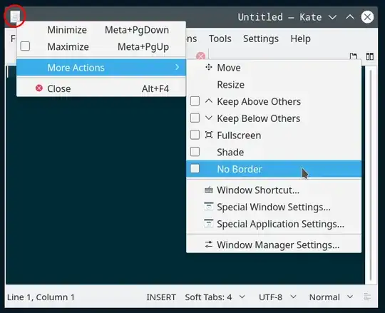

Unlike many other desktop environments, KDE Plasma doesn't use Alt+Spacebar as the default keyboard combination to bring up the client window menu to which you refer. One has to use Alt+F3 or one can click on the Menu button (circled) usually at the top left of the window's titlebar:
Alt+F3 or menu button
If you wish to change things, you can via Custom Shortcuts. I've have an answer here that describes changing shortcuts which you may find helpful.
I'm not going into specifics because keyboard shortcuts are a matter of personal choice and they also depend on what other shortcuts you have set up or intend to set up in the future.
