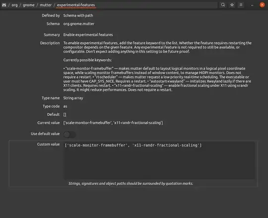

This works fine in my case, using 3k notebook and 1600px monitor with different scale:
  1. Open dconf Editor.
  2. Go to /org/gnome/mutter/experimental-features
  3. Disable "Use default value"
  4. Write custom value: ['scale-monitor-framebuffer', 'x11-randr-fractional-scaling']
Now you can use different scale for each screen in the display settings.
dconf setting capture
Scale 200% in screen 3000x2000px
Scale 100% in secondary screen 1600x900px
Tested in Ubuntu 19.10, GNOME 3.34.2.
