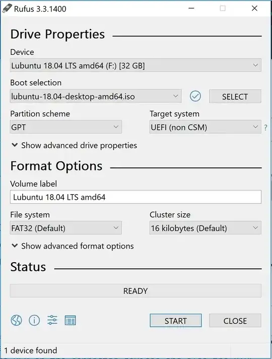

These are my Rufus settings.

I've had same problem. Finally I fugured laptop's cpu is 64bit architecture, but it's bios has only 32bit uefi. You can't boot normal 32bit system (32bit systems usually do not use uefi) and you can't boot 64bit because 32bit uefi won't load 64bit bootloader files.
