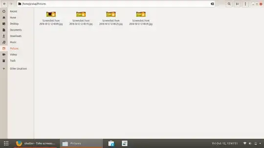

I have just started learning Ubuntu.
I don't know this method is proper or not.
I Could achieve it in the below way.
I have created a script like this named ScreenShot.sh in the folder /usr/local/bin
#!/bin/bash
# NAME: ScreenShot.sh
# PATH: /usr/local/bin
# DESC: Take Screenshots at every specified intervals with "watch -n 10 ScreenShot.sh" Command
# DATE: Oct 12th 2018
sudo gnome-screenshot -d 0
sudo chmod a+x /usr/local/bin/ScreenShot.sh

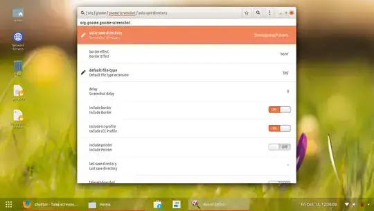

when i start the system and wanted to start the screen capture at every 10secs,
i run this command
sudo watch -n 10 ScreenShot.sh

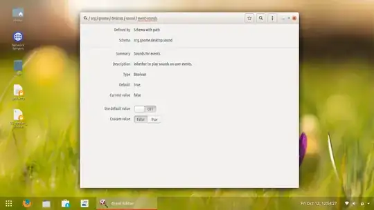

i have configured my default folder, image type to be saved, with dconf editor in gnome-screenshot section.
Sounds are stopped by dconf settings under sound section
