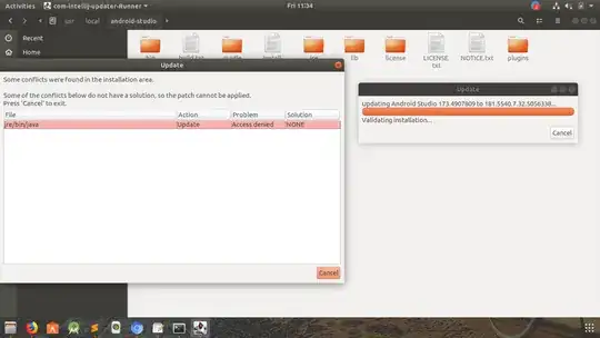

While updating Android Studio I got the following error. The patch was downloaded and extracted, but there was some conflict with jre/bin/java Access denied. The error message is shown in the below screenshot.
The Error message is as shown in the linked image:
(Click image to enlarge)

64
Kill java for update
ps -A |grep java
output of this command will give the list of java processes running on your system. Note down Process ID (PID) of that process whom you want to kill and run
kill -9 PID

What I found worked for me is with Android Studio running (before initiating the update patch download) I did ps -ef|grep jre on the command line and saw there were 2 jre process running, the one for Android Studio and one of which was for the Gradle daemon which was also using the jre shipped inside Android Studio. The Gradle daemon process will have something like this: gradle-5.3.1/lib/gradle-launcher-5.3.1.jar org.gradle.launcher.daemon.bootstrap.GradleDaemon 5.3.1
towards the end of its command line when you list processes with ps though of course the specific version you have may not be 5.3.1.
Killing the Gradle process and then starting the update download and then restart from inside Android Studio let the update proceed successfully.
