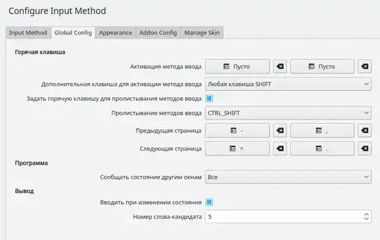

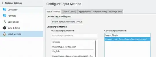

After that, I installed fcitx and configured input methods. Switching shortcut is Ctrl+Shift, i.e. Caps Lock switches En/Ru, Ctrl+Shift switches En/Ch.
input method config
input method shortcuts
The problem is that fcitx always watches keyboard input. When fcitx is running, switching layouts and input methods (both with Caps Lock and Ctrl+Shift) is possible only when some text area controls (not just window) has focus. So that when I try to switch keyboard layout and/or input method in an applications such as web browser, I cannot do so.
