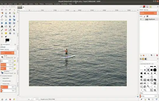

Any supported version of GIMP can open raw images with gimp-dcraw from the default Ubuntu repositories. The gimp-dcraw plug-in integrates with GIMP apt packages only, it does not integrate with either GIMP snap packages or GIMP flatpak packages. Therefore if you're a stickler for GIMP version 2.10, you'll have to wait for two weeks until Ubuntu 18.10 which has this version of GIMP in the repos is released.
To install gimp-dcraw open the terminal and type:
sudo apt install gimp-dcraw
The proof that this plug-in works is shown in this screenshot.
off color raw image in GIMP + gimp-dcraw in Ubuntu 18.04
The problem with this method is that the colors of the raw image look off color and not like colors in the original image. The water in the image is supposed to be blue, not off color. You can see the original image at this answer. The solution is to stay with Darktable. I tried opening raw images in GIMP, Krita, and Darktable and only Darktable has an acceptable level of color accuracy for raw images by default.
