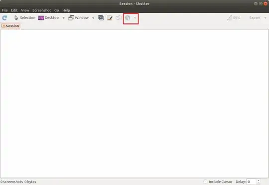

I want enable globe in Shutter for taking screenshots of whole web pages.
globe in Shutter
For enabling globe I need install gnome-web-photo package. I use this command
$ sudo apt-get install gnome-web-photo
I get an error
E: Package 'gnome-web-photo' has no installation candidate
