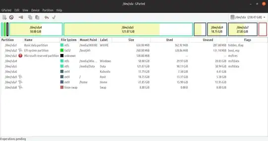

I had a dual-boot system with Windows 10 and Ubuntu 18.04.1 and I wanted to try Kubuntu 18.04.1 as well.
So I've edited my partition table, created ~12GB for that cause, installed Kubuntu on it and my partition table looks as follows (I've also created a separate partition for my home folder in Ubuntu) enter image description here
What followed is that Kubuntu's GRUB override Ubuntu's, it showed all the 3 boot options but from that point on I couldn't restart and boot from Windows to either Linux OSs or from one Linux OS to another without getting this error message
fsck.ext4 Superblock checksum does not match superblock while trying to open /dev/sdaX
enter image description here As you can see in every reboot I get the (initrmfs) menu and have to manually fix the filesystem using this command e2fsck -pb 32768 /dev/sdaX enter reboot and go to the specific entry (mounted sda) that I fixed previously.
It looks like all 3 ext4 linux partitions Kubuntu, Root(ubuntu), Home(ubuntu) share the same superblock
