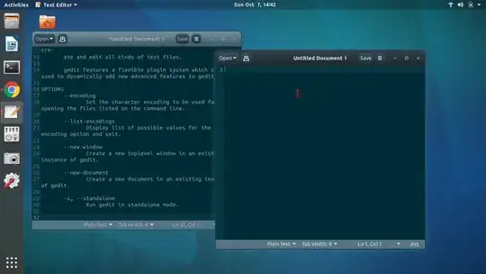

$ gedit --version
gedit - Version 3.28.1
I opened gedit from the launcher, pasted part of man gedit into it, and then opened gnome-terminal and ran gedit -s & exit. This opened gedit in a new window.
From man gedit:
-s, --standalone Run gedit in standalone mode.
Two instances of gedit
Edit: I don't have pluma installed but man pluma doesn't list the -s option. It does have
--new-window
       Create a new toplevel window in an existing instance of pluma.
--new-document
       Create a new document in an existing instance of pluma, on the
       last Pluma window that had focus.
similar to gedit's
--new-window
       Create a new toplevel window in an existing instance of gedit.
--new-document
       Create a new document in an existing instance of gedit.
