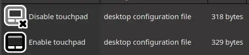

Create two desktop launchers with the following contents:
[Desktop Entry]
Name=Disable touchpad
Exec=synclient touchpadoff=1
Icon=/usr/share/icons/HighContrast/256x256/status/touchpad-disabled.png
Terminal=false
Type=Application
Categories=GNOME;GTK;Settings;HardwareSettings;X-GNOME-Settings-Panel;System;
and
[Desktop Entry]
Name=Enable touchpad
Exec=synclient touchpadoff=0
Icon=/usr/share/icons/HighContrast/256x256/devices/input-touchpad.png
Terminal=false
Type=Application
They will appear like so:
You can put them in ~/.local/share/applications and run them as any other application by using only the keyboard. I find this method most convenient. With a mouse attached such launchers can also be used on a panel or the desktop.
